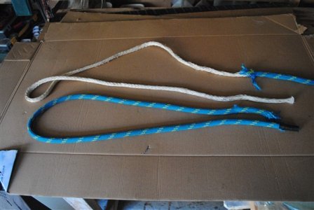

On a different note. Sometimes I doubt that stitching would help. This 14mm dynema cored line was on a cleat & the load was a 2.5 tonne sinker hanging in water when it gave way without warning. 2 crew men could easily have been injured. The outer covering remained on the cleat
