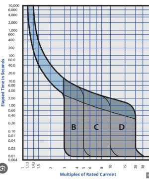

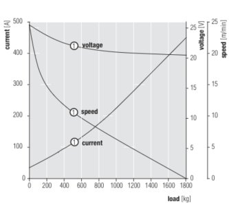

An example may make the reasoning clearer. Below is a graph of current vs pull for my windlass. This windlass is nominally rated at 2000w at 24v and the manufacturer recomends a 135A breaker. I have also posted a typical breaker trip curve below.
At full load the graph below shows that my windlass will draw 450A (over 9kW o_O). The trip curve of the breaker shows it will withstand this current for around 6 seconds. At around 270A the windlass will pull about 2/3 of its maximum load and the breaker will trip in about 20 seconds.
At 135A my windlass will pull about 1/4 of its rated load and at this current the breaker will never trip.
If Maxwell have done their sums and practical tests correctly, my windlass is continually rated at 1/4 the maximum load. It can pull at 2/3 the maximum load for around 20 seconds and the full maximum rated load for around 6 seconds before overheating. If this was not the case, Maxwell would have recommended a smaller breaker. This would reduce the run times before the breaker trips. If the motor was more resistant to overheating, Maxwell would have recommend a larger breaker and this would increase the run times at the various loads.
So a breaker can be selected with a value and a trip curve that will protect the windlass from overheating over a wide range of loads. While this is not a perfect system, it works well in practice with few reports of motor damage from overheating, but you need to follow the manufacturer’s guidelines for this system to work.
