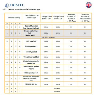

It took me almost a year and half a dozen emails to extract the info from Exide regarding the correct charging and float of their ER350 battery which was prompted by my domestic set gassing off when left on charge on the pontoon hooked up to the boat's Cristec charger. I found the charger had been left on it's factory default "sealed lead acid 13.8v float" setting rather than open lead acid with 13.4v float, so I flicked a DIP switch to correct that and the gassing stopped. The ER350 spec says float at 13.7v though.

All I have to do now is work out which DIP switch setting is best for the Cristec Y Power 12v/40A charger we have on the boat.
Also, since the charger only supplied power from the shore power input, the alternator is connected to the Cristec RCE battery isolator, I wonder how the max current and float voltage is controlled when charging from the engine alternator? I've seen 50+ amps on the NASA BM2 which is more than the battery spec of 40A.
