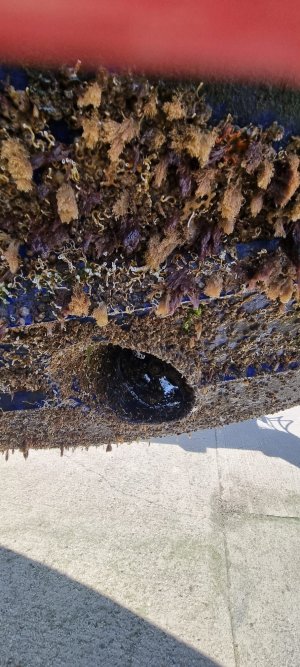

We were out for a scrub and some antifoul in April but last weekend we were down to 14kkts, with a normal cruising speed of 25knts, 28kts flat out. So, it's time for another scrub. Ipswich wanted £400, after taking off 30% because we're annual berth holders ! Suffolk Yacht Harbour are doing a Summer special, £250 for our 45ft boat. The travel hoist looks a bit tight, tucked in the corner, but there's a little pontoon that you tie up to and the "boat crew" walk the boat in. I have to say, what a great team ! Nothing was too much trouble, they did a really good job and didn't rush me when i asked if i could give the props a quick once over with a big wire brush on a grinder. We'll definitely be using them again.
There were so many barnacles in the bow thruster tunnel and on the props that it's performance was seriously affected

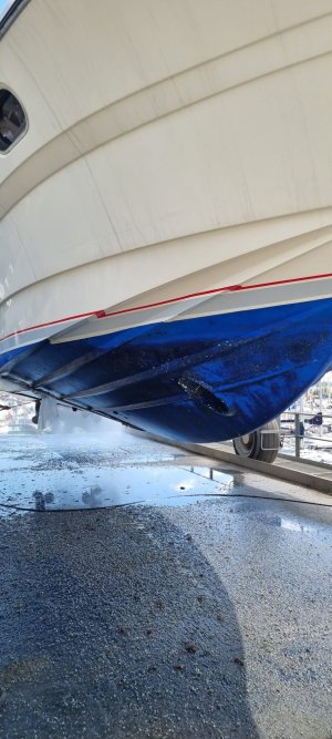

Looking good again (y)

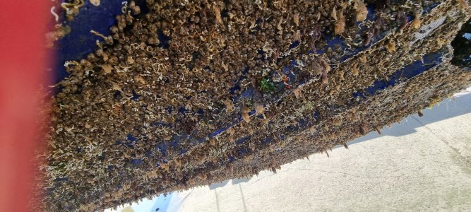

Is your boat moored in the same location as last season?
Should add, we do actually use the boat too, we've done 40 hours and over 300 miles so far this season.
In the second picture you can see tufts of some sort of plant, these are 2-3 inches long, never seen anything like those before.

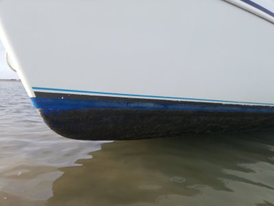

Walton Backwaters with SML Paints CuPro mid season.

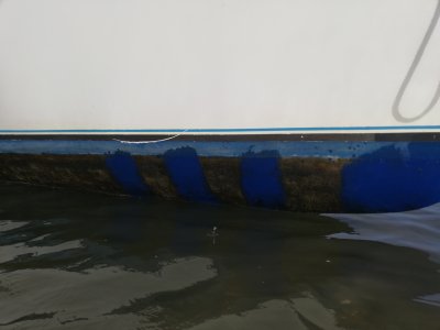

Out for annual jetwash and A/F in March ready for the season.
Out again in May having "lost" several knots and also needed to replace a couple a couple of prop anodes, hull fouled with slime and barnycules on stern gear.
Last week having lost about 7 knots coming back down from trip up to the non tidal Thames, boat went back on drying blocks today.
Covered in Slime and loads of middle sized barncules on both hull and sterngear.
