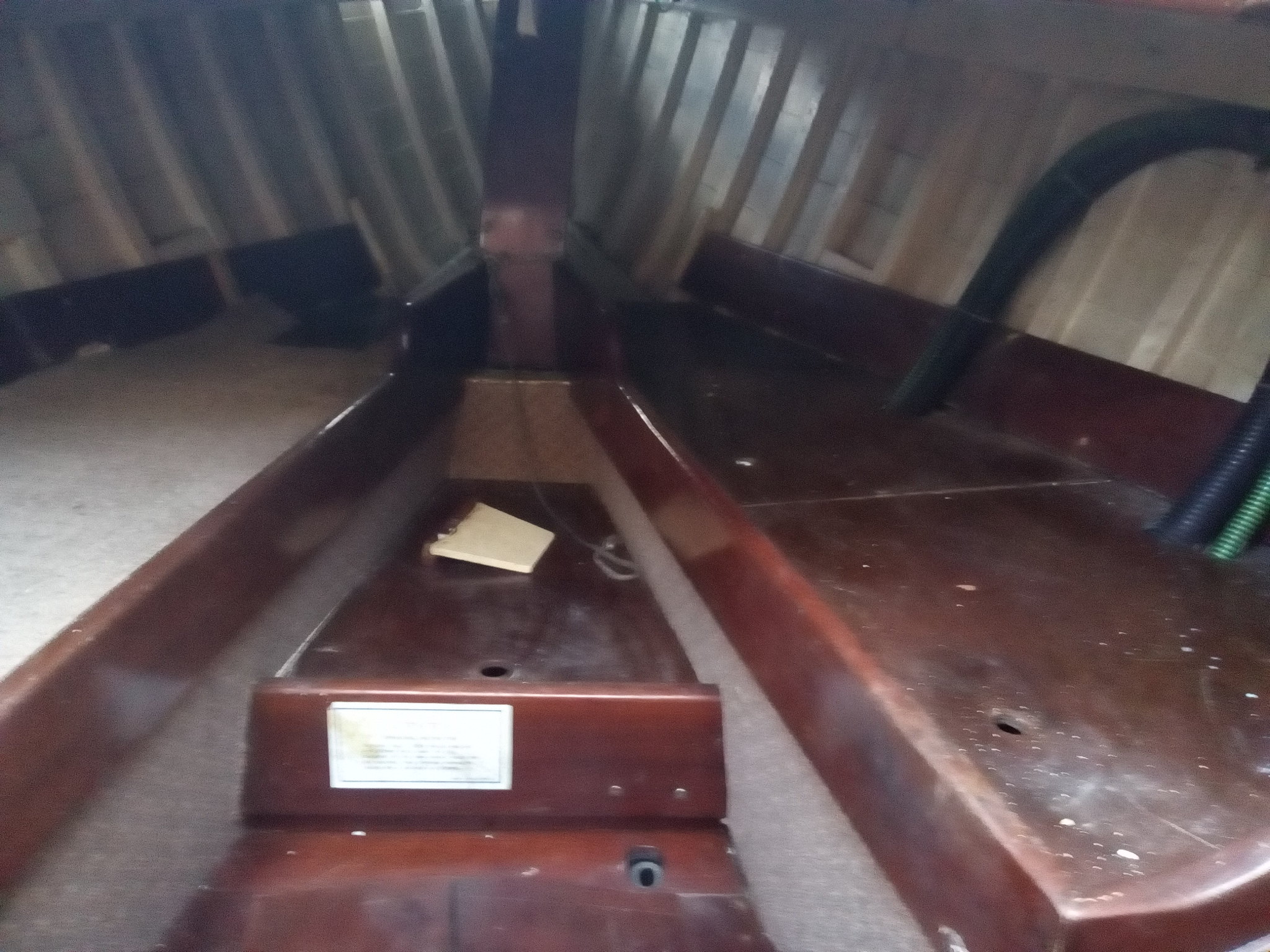

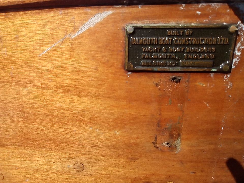

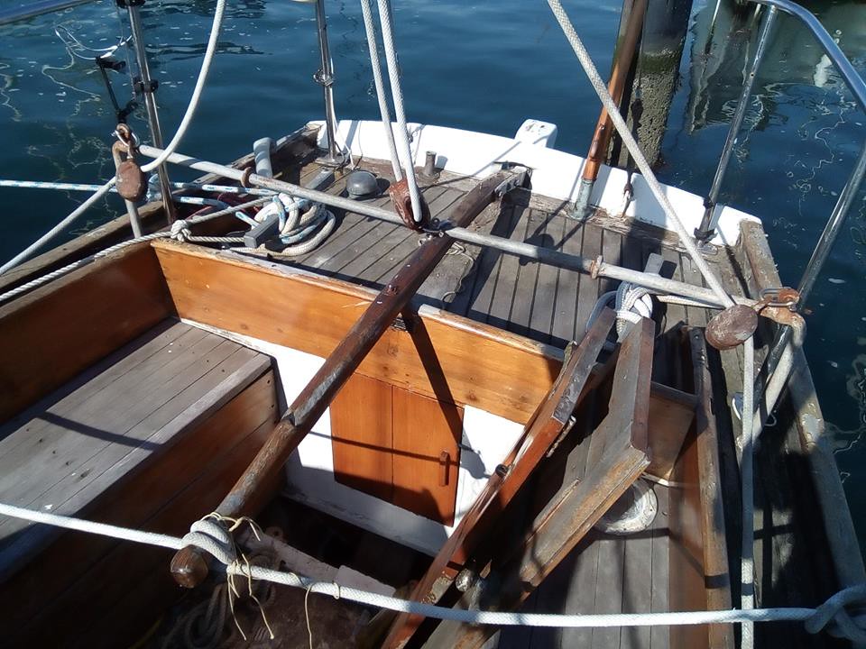

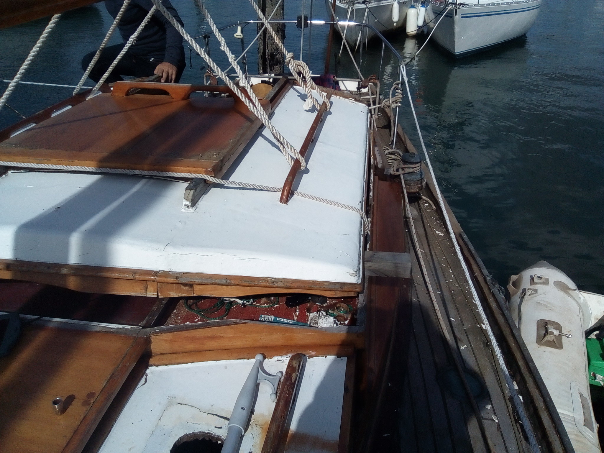

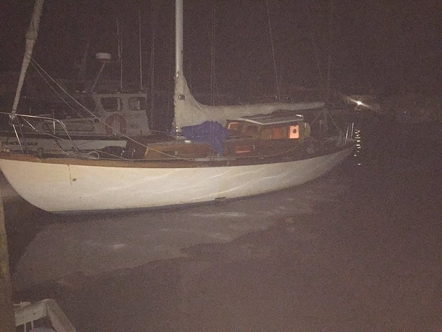

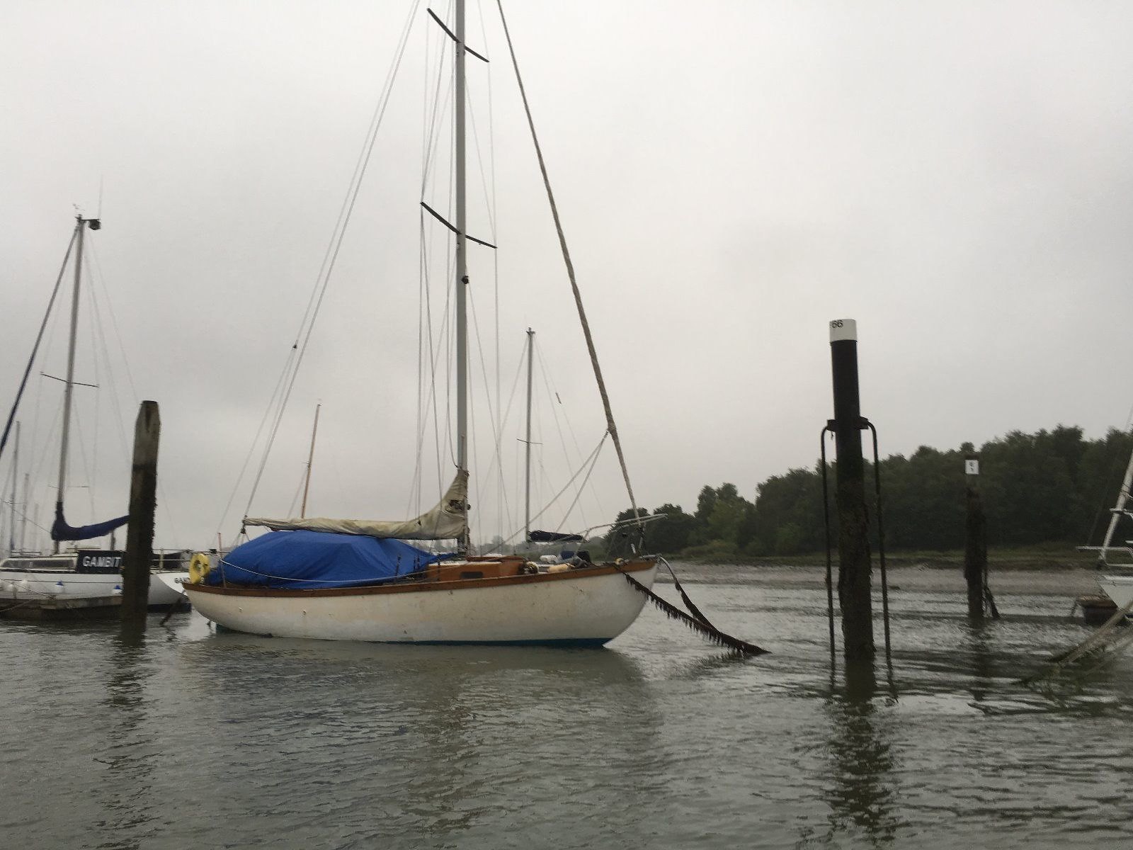

But we finally did it anyway, and Karen and I are now proud owners of our own old classic wooden tub.
30ft, needing some remedial work, not least where the previous owner took a saw to the pilot house and attempted a roof chop.

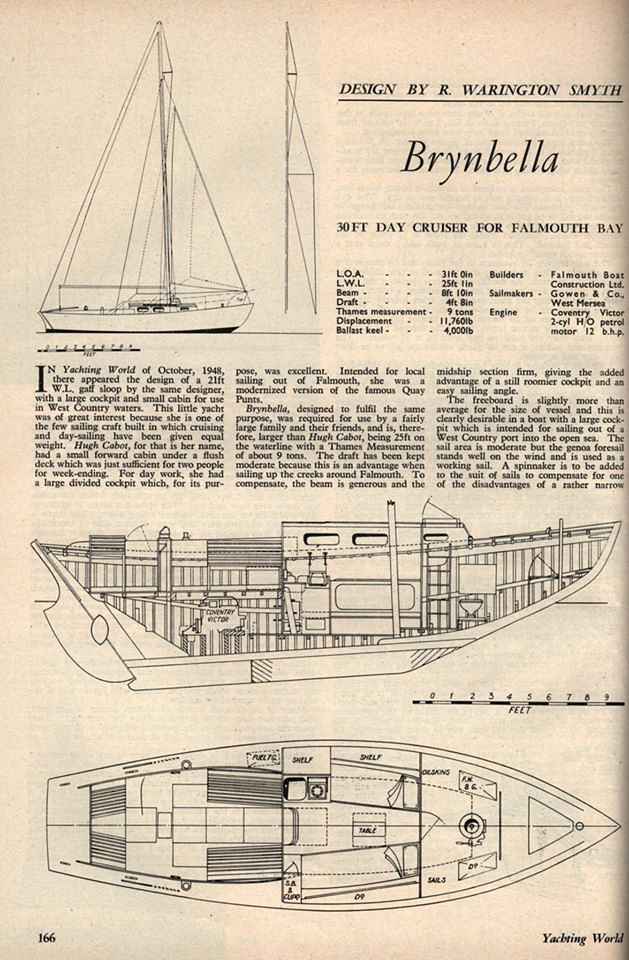

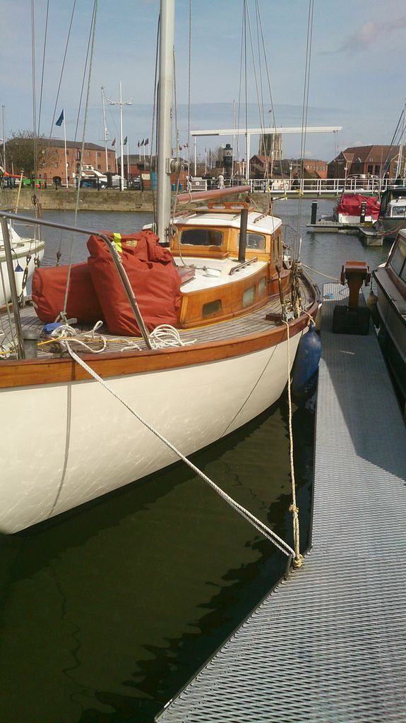

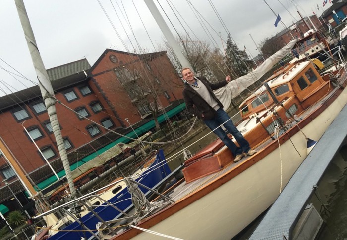

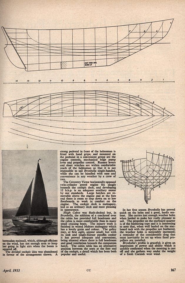

this is how it looked before the coachroof was hacked about, and how we plan to reinstate.

Yes there is a fair bit to do, hopefully most of it within my skill set!
Work schedule is to be little and often. Once the cabin is reinstated to a degree of waterproofness, then I will tackle the few rot patches I have found so far (less than I had expected) and repair the smashed rubbing strake and gunwale at the bow.

Do you know the history of the boat and its designer/builder? Very well respected in his day.
Can't understand why the PO chopped the doh house as it seems to suit the boat.
We have just two boats now, others sold.
I am doing research into this one, so any info gratefully received. I am reinstating the pilot house for several reasons. The remaining roof is well made, but the PO obviously did not realise it would not be wide enough once the sides were chopped, same as a car roof chop. Even lower as it is now, there is still standing headroom, but it is simply going to be quicker and easier to put it back as it was rather than widen the roof. Once that is done it will be properly watertight again.

About twenty years ago I became interested in her myself but she had not had any extra accommodation built at that time and the overall layout was a bit unconventional for a 9 ton yacht. Was looking for a 9 ton Falmouth Pilot by the same designer. Did not buy her but later saw her in Ferrybridge boatyard in Weymouth/Portland having the alterations to the coachroof done by, I think, the new owner at that time. Then suddenly saw her for sale very recently jogging my memory.
