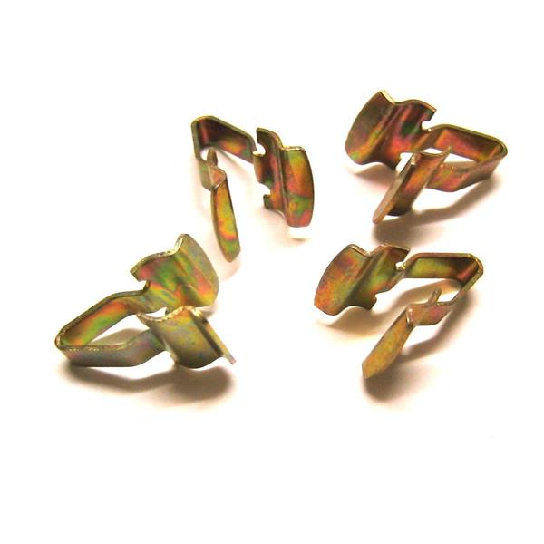

One of the pan support clips broke last time it was removed for cleaning. Nothing very complex, just small metal clips to hold the pan support in place.
No problem, I managed to find a pack of 4 and thought the others would be fine as spares. Until I saw the price of £21.75 incl. delivery from Socal
Wow, I must have found the solid gold variety or perhaps they're Unobtanium based.
I couldn't find a generic alternative on Google, anyone know what they are called? I imagine they are a type of clip for rods or pipes.
We did the same, bought of Socal at SIBS a few years ago, was gob smacked at the price! Then realised that careful coaxing with a pair of pliars fixed the originals. So, a pack of four still sitting in the spares box!
I managed to tease 3 back into shape but one split into 2 parts. Obviously bent back and forth too often in the last 10 years. :D
I expect you will eventually get to use a couple of the spares.
I wonder if a pipe retention clip might do (It is PBO after all). I could mount them on small stainless screws with a nut underneath. They'd probably look better than the original non-stainless clip.
