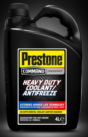

...there are a variety of colours and not much standardisation...
Very important point.
One of the most common misconceptions is that the color identifies the type or properties of the coolant. Cleverly orchestrated by car manufacturers' marketing who want people to buy everything from their repair shops.
This is completely wrong because every type of coolant comes in every color.
I've switched to Command Heavy Duty Coolant/Antifreeze | Prestone, which universally replaces everything else.
