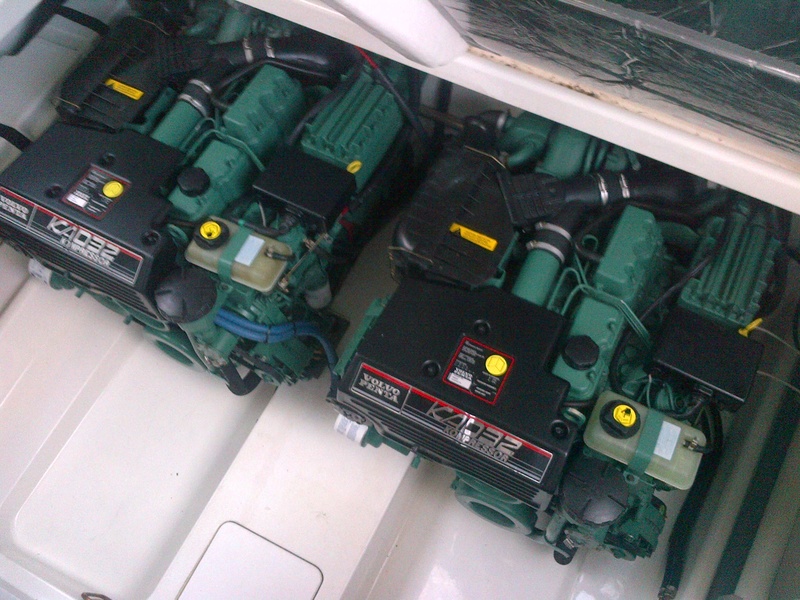

I don't use any special products but find mild detergent for leaning the engine bay floor. My engine bay has a gel coat finished liner which makes it easy to clean. The engine bay cleaning took several passes to get it up to standard but maintaining it is perhaps half an hour job every couple of months. Some areas of the engine bay are hard to reach so they are not as clean as the photograph might suggest.

Spotless, very impressed. Did you have to paint the engine bay or just clean it (repeatedly) to get it like that?

That is immaculate :cool: I'm guessing you have taken the belts of those KADs to keep it like that ;)
No paint has been involved. The floor has a gelcoat finish as the exterior of the boat .
The belts are in place.
The picture was taken just after cleaning. Belt dust is not significant if the belts are in good condition.

There is some very light staining where some fluid has been allowed to stand in the past . But no need for painting.
The gloss gelcoat finish makes cleaning an easy job .
My boat is 13 years old so the gelcoat is surviving very well.
