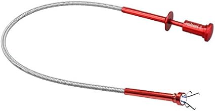

My sockets are chrome vanadium and are not magnetic unfortunately. I have one of these but it's equally useless because I cant see what I am grappling for most times. My bilge is for tools and bolts what washing machines are for socks. Loads of f***ing fairys playing silly bu**ers with my head. 18 hours is what it took for me to change one turbo :cautious:

They are mostly steel, CrVn is only a few percent; get a neodymium or similar magnet, and provided you can avoid it sticking irretrievably to the engine block or other steel things it will pick up your sockets. To avoid further such irritation you could try one of the Wera Zyklop socket sets as they lock themselves together, pricy though.
