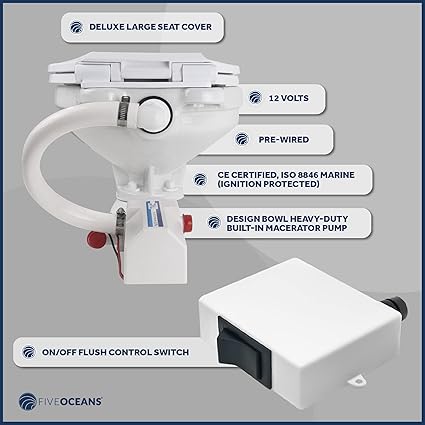

Is this the type of TMC head you have
https://m.media-amazon.com/images/I/71CIzpfu2mL._AC_SX425_.jpg
if so the flush pump is in the same housing as the pump out macerator.
I had one of these and it went rusty and stopped working
I replaced the pump out pump with an electric diaphragm pump and the flush pump with a seprate fresh pressure pump with 2 sperate switched so I can pump out and flush in which ever sequence I wish
