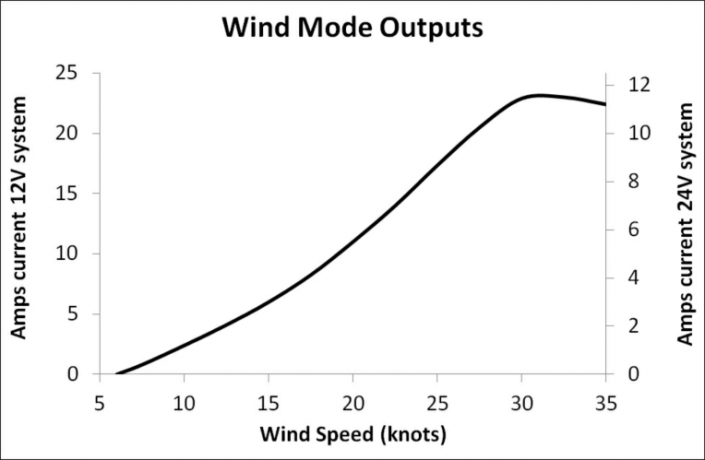

I have bought a boat which is fitted with a DUO GEN and I am surprised by the output. My boat is 24V so the amps are different to a 12V system. In 12knts of wind I am generating 1amp(2Amps at 16knts). Is this normal? I tried calling DUO GEN but could not get a sensible answer and they suggested a dealer visit. Obviously a dealer visit is fine if there is a fault but if this is as good as it gets then I don't see the point.
I have not tried the generator in water mode.
Duo Gen 3 suggests 5 amps at 15kn. Manual on the Duo Gen website with expected performance tables in the back.
I think that's for the 12 volt version !
Expect only about half of that for the 24 volt version

Are your batteries sufficiently discharged to accept more current . See the section in the manual regarding performance expectations
Performance and Expectations
The DuoGen was spsecifically designed to maximise zero carbon electricity generation on cruising yachts. The
DuoGen’s unique wind/water capability works best where cruising yachts are making frequent or long sea
passages, interspersed with periods at anchor or in harbour.
The DuoGen should perform in line with the values given in our published output graphs. However, when
monitoring the system, external factors can effect performance, and that may lead you to falsely conclude that
there is a problem. To assist in accurate evaluation, particularly in relation to wind mode, be aware of the
following:
● When monitoring the wind mode, wind speed measurement should be made at the height of the turbine
rotor. Where a mast head anemometer is used, there will be significant wind shear, and it is not unusual for
wind speed measurements at turbine level to be 30-50% lower than at the masthead. This is particularly true in
harbours and marinas.
● When measuring performance, battery state is also important. Fully charged batteries do not readily accept
current, and where a charge regulator is fitted, any dumped power will not be registered by the ship’s battery
monitor. In addition, where batteries are fully charged, or the regulator is ‘dumping’, the load seen by the
DuoGen’s alternator changes. This makes the alternator ‘stiffer’ to turn, which in turn increases the force which
furls the turbine. The increased furling angle reduces the intercept area of the DuoGen’s air rotor which in turn
lowers the electrical output.
When evaluating the DuoGen’s air mode, try to ensure batteries are 30 - 40% discharged, or alternatively
switch on numerous electrical loads in order to pull the battery voltage down.
● If wind mode outputs remain below expectations, first suspect turbulence in the wind stream. Turbulence at a
given site can be specific to a particular wind direction where it is caused by an obstruction either up or
downwind of the turbine. When the wind direction changes, and the obstruction is no longer in line with the
turbine, outputs may return to expected levels.
● If poor output cannot be attributed to site conditions, re-check the whole installation against the wiring
diagram and also look for poor or loose connections. Also, check fuses and fuse holders.
● Finally, ensure that the batteries are in good condition and of sufficient capacity. We recommend a minimum
of 300 Ah for use with the DuoGen.
If you still suspect a problem with the machine, consider the following:
● Do the air blades spin freely? The air rotor should spin without any undue noise or friction. If not, is there a
braking switch engaged or could there be another short circuit in the output cables? (Make sure you
disconnect the batteries before trying to find out!)
● Is the DuoGen free to move about its yaw axis? It should move easily with no undue noise or friction.
If in doubt, refer to your dealer or the manufacturer​
