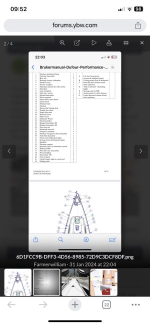

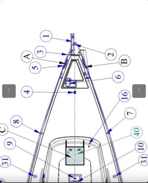

I am looking to buy an inner forestay deck strongpoint kit that is clearly shown on the manual and some sisterships have factory fitted.

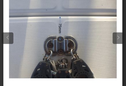

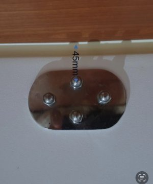

I appreciate that it may be better to get the parts from Wichard and to fabricate a backing plate. However, I need to understand how best to key in to the existing strongpoint (assuming some structural enhancement of the bulkhead) and to check that it is safe for big loads.

Is that point on the deck actually intended for an inner forestay: might it be intended for spinnaker guys instead - probably lower loading?
Farmerwilliam
20 Sep 2017
21
Yes I want to check that. In the manual it is described as as “running forestay chainplate” which suggests it is appropriate.
