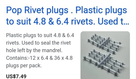

Since others have already suggested pop rivets, I'll just add that to finish them off nicely (and to save being left with rusting mandrels), you can push the mandrels through, catch them lower down and then plug the holes with these..
