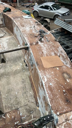

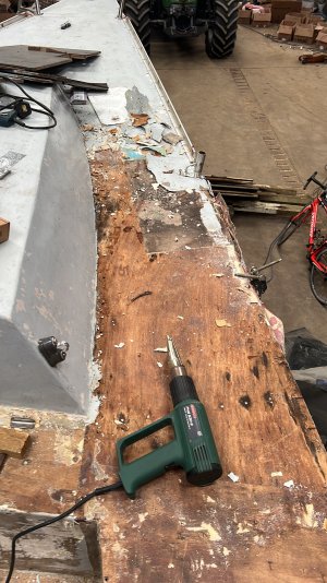

That’s the plan. Started to strip paint from the cockpit which was peeling. Looks like the wood has been reinforced with GRP but has sealed in the wet. Will let it dry out some before taking meter readings and see whether it can be saved or needs replacing.
I’ll keep the dehumidifier going whilst it’s extracting what looks like a good amount of water but will consider natural air circulation. The issue is a single entry point doesn’t support airflow. There is a deck patch which looks like it will need replacing so I could remove that.
Ref project viability, I won’t know where I stand for at least a month, what I’m know so far is that there looks to be a lot more work than first thought.
