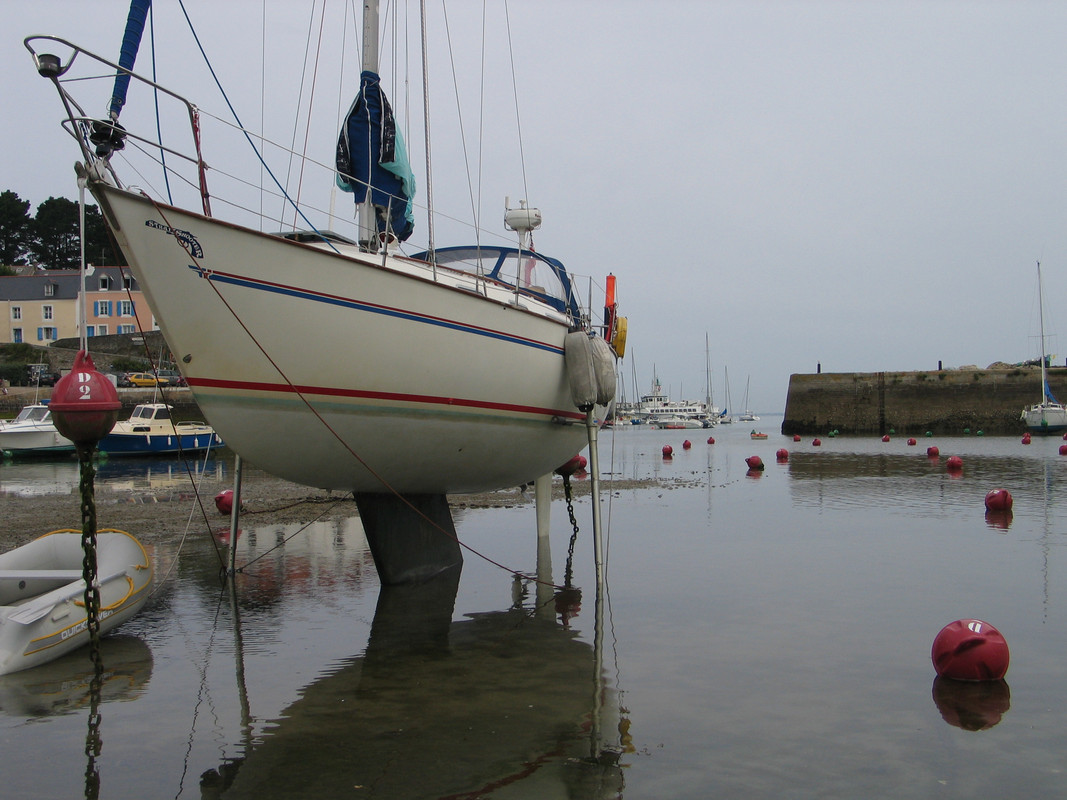

This one was taken in Belle Ile. The alternative was to moor bows-in with about ten other boats on a buoy that on the day was quite exposed to wind and waves. No contest!
