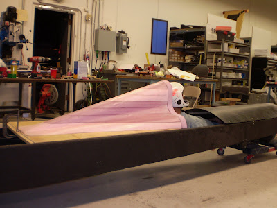

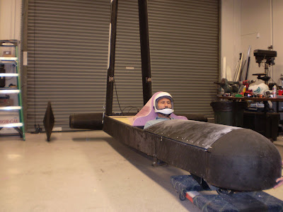

We finally have the downwind cart more or less completed. New aerodynamic fairings, strengthened transmission, variable pitch prop, logging of GPS and wind speed and direction, and even it's own trailer (finally).
We took it out for some testing yesterday, and had reasonably good luck with the wind conditions. We got about 2.85X wind speed in 12 to 15 mph winds.
Hopefully we'll be making a run for the record in the next few weeks.
