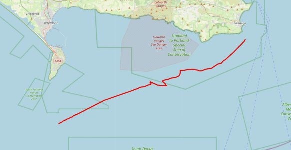

An odd thing happened when we were on passage from Torquay to Studland last week. The inner ranges were active so we routed to keep south of 50'34" as requested but on the leg, the SOG kept jumping up to more than 30 knots and my BTW info jumped all over the place. We were riding some pretty large swell but average speed was generally 8-9 knots.

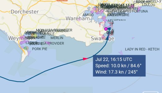

The Marine Traffic trace looked smooth and resembled what we really did but the GPX file from the chart plotter shows the track it thought it did. My sailing isn't so bad that we lost control like this so I wonder if there was local jamming going on.

I wonder whether marine traffic smooths out your or anyone elses position ?
I wondered that. My system is set up that the chart plotter uses it's own internal GPS as source and of course the AIS has it's own with separate antenna. I wonder if there was some low level jamming that affected only the chart plotter as the military wouldn't be able to jam larger ship GPS/AIS without a prominent notice.
It was weird that it all stopped around 5pm when the ranges shut down. I liked his closing announcement too, "see you in September".

Chart plotter gets it's GPS internally, ie via the screen which is open to the elements. Never seen this behaviour before or since. Just that narrow "Lulworth" window.

Marine Traffic might not be using every AIS transmission to display on the web, what use would it serve? So you throttle back the number of 'AIS pings' displayed and the reduce the processing on the back end server.
Presuming OP has a class B AIS transceiver, he will only be pinging a position out on AIS every 30 seconds, whereas his plotter-generated GPX is likely utiliising data at a higher frequency than that, which could alone explain some smoothing effect.
Specifics on MarineTraffic (I run a station). Terrestrial stations transmit every AIS ping they detect (so every 30secs for every class B contact in motion they can pick up), however MarineTraffic updates the vessels (in motion) once every 60 seconds (i.e. every other AIS Class B transmission, give or take).
