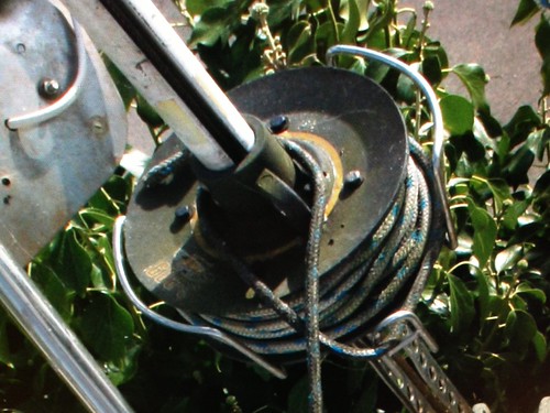

Can anyone give me the model of this furler? Excuse the green slime, this was how the boat was when I got her.
Basically, I want to order new sails, but I'm wasting area as the headfoil is a bit short on the forestay. I'm trying to identify what the furler is so I can try and source another section. I can get a better picture next time I'm on board, but it's a long way away right now!
Also, anyone got any idea who might stock the sections? I know I might be out of luck, especially if it's a plastimo, but it's worth a punt before I get new sails made.
Thanks in advance.

The bent wire line guides look like Facnor to me. All the others I can think of enclose the drum with a shield instead.

I think it might be a Plastimo 608 too...it does look like it says it on the drum on closer examination of the picture and googling 608 brings up some very familiar pictures of the top part.
Couple of leads to go at then...hoping I might be able to get a piece and get a bigger genoa!

It looks exactly the same as ours, which isn't a lot of help cos I don't know the make either. Howebever, according to some info on the Leisure Owners Association website, Plastimo is mentioned. I'll post a picture on there and see if I can get any answers.

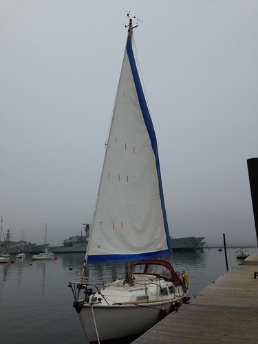

Update...
Many thanks again for all the help and offers of parts. Seateach had all the bits I needed, including an old off cut of headfoil at a fraction of the price of a complete section. So last weekend I fitted the new piece (without needing to remove the forestay)...you can see it about a third of the way up.
That's the old genoa on full hoist...so for the sake of a day of tinkering and a few quid I will have gained quite a bit of area as the new sails are being made to fit the extended foil, perhaps a couple of square metres or so. And it will look a lot better aesthetically too!
Thanks again!
(oh, and no more blue UV strip...white this time!)
