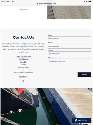

Seastoke
20 Sep 2011
12,931
Here look at their web site ,I would say 20% of our marina use them including my self .
