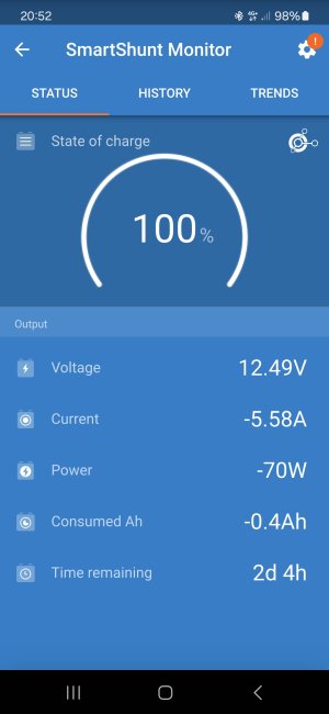

I'm getting some odd readings from my leisure batteries. They're just under 3 years old. 3 x 115AH Exide lead acid...
I'm not experiencing any issues with power. I use the fridge, tv, laptop and heater regularly. However, the voltage seems really low despite the monitor showing 100%. The boat panel and heater all report about the same voltage.

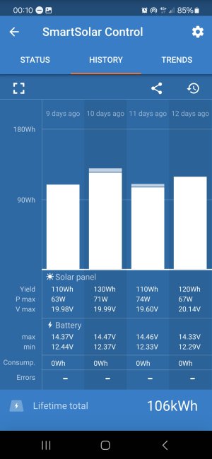

I have a Victron SmartShunt and Smart Solar MPPT controller connected to a 160w Renogy panel. This is connected all the time and over winter I occasionally motor about and connect to shore power for additional charging.
See attached screenshots. I'm kind of coming to the conclusion that the batteries are on the way out which is a bit disappointing after such a short time. Any thoughts? I know that the SmartShunt measures the net gain/loss from the batteries but seems to conflict with the voltage.

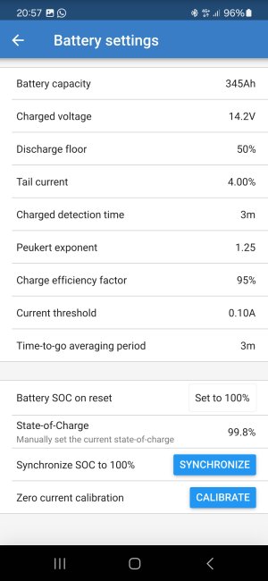

Second screenshot shows voltage in blue (over 30 days) - seems to drop really low...? I've also attached settings from SmartShunt and MPPT controller. I think the settings are ok - I did a fair bit of reading at the time I set them up but happy to be corrected... (note that current draw in first image is because I'd just switched heater on)

As you have consumed 0.4 Ah then that is why you are showing 100% charged.
You are drawing 5.58 amps hence the voltage is 12.49.
How much charge are you solar panels giving you? You will get that figure from the MTTP.

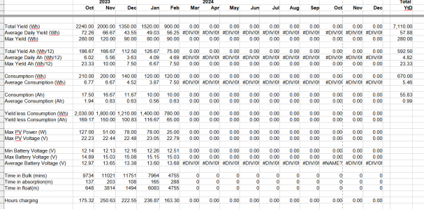

I'm running a wee spreadsheet to look at the solar panel output. A screenshot of the summary page below.
In the settings you have "Synchronise State of Charge to 100% on Reset" enabled.
Let's say you're doing stuff on the electrical system - the batteries are at 80% and you disconnect the Smart Shunt; when you reconnect it the SmartShunt will now say 100%. Now you run it down 20% more - the Smart Shunt says 80%, but it's really at 60%. Do you see where I'm going with this? I killed my batteries this way, thinking they were well charged,
This is potentially a very dangerous setting, and it used to be the default - they upgraded the firmware within the last year or two. When you press on where it says "Set to 100%" you will see there are three options, but there used to be only 2 (see this screenshot) and set to 100% was the default.

Couple more screenshots showing recent solar input (pretty rubbish in winter)
Also full csv attached.

I never really disconnect anything so I think the sync setting should be OK. I've occasionally manually reset to 100% after being on shore power overnight though...
Interesting data,
What size, watts, are the panels? Are they all the same or do you have different sizes?

Interesting data,
Jonathan
The panels are 2 * 100 watts.
They are currently only placed on the deck thus not ideally positioned for maximum power generation. Added to that it has been a wet, overcast winter in Cornwall and they are there to keep the batteries topped up between visits.
Once we get on the water and are sailing I be far more active in positioning them for maximum power generation.
