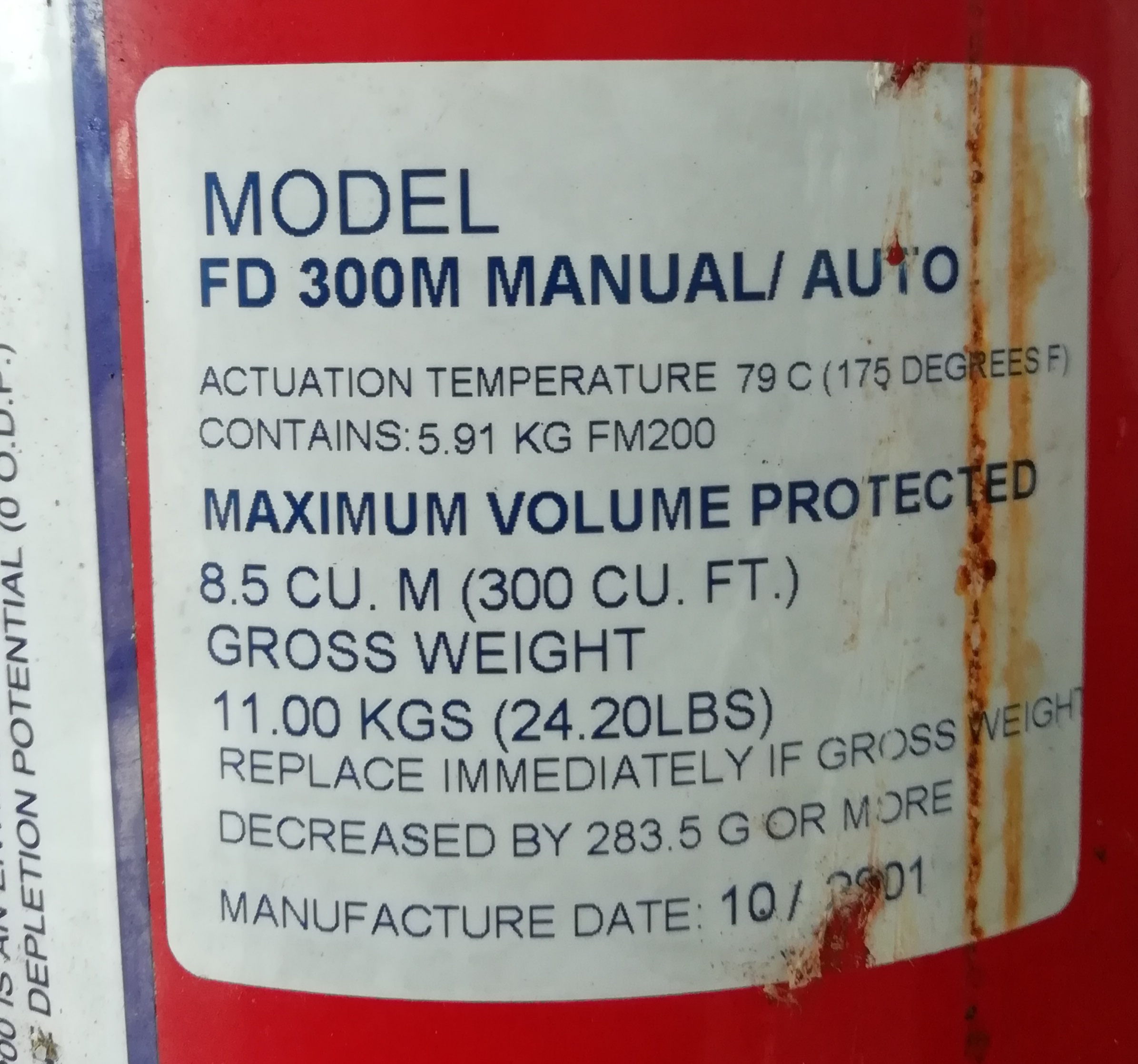

1st day of holiday, thought it was sensible to get the Sea-Fire engine bay fire extinguisher serviced. Stupid ***** set the thing off. As it's the original 2000 one they're saying it can't be refilled. Replacement will take 10 days to come.
Does anyone know a firm that can send a replacement by fast courier?
It's connected to the Sea-Fire system so engines wont even start now that it's fired.

Watch out for the insurance position of operating the boat with no auto fire extinguisher on board (although from your photo above, if the cylinder has never been serviced before you were probably already in trouble on this point).
