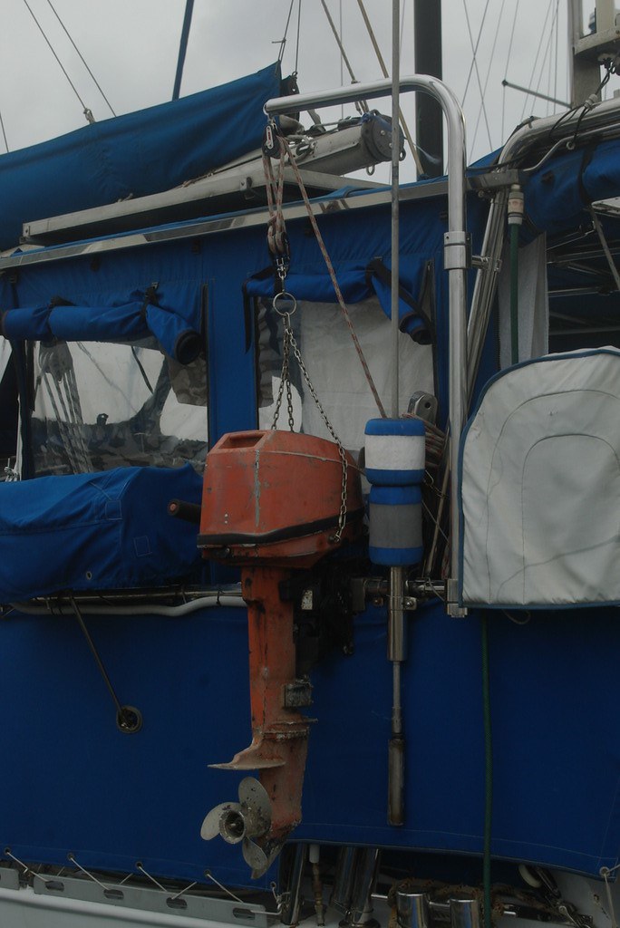

This is how I lift and store my dingy outboard. Can also be used to lift MOB if need by
I have a second long shaft outboard on the stern rail than I can lower on tp the stern of the boat as a emergency backup engine of to mount on a dingy if necessary
This is my outboard crane, made out of 25mm tube. The upright tube has a 22mm tube down the centre of it to reinforce it. It’s got a four to one handy billy to lift the engine up and down. The joins and connections are all standard 25mm fittings. Been on the boat for about 5 years now and makes fitting and recovering the outboard a one person job. I usually lift the engine off the bracket, move to the dinghy and complete the evolution from there, as the cleat for the handy billy is easy to reach from the dinghy.

I have an 8 ft inflatable dinghy (which these days I think is probably a bit small) but I suppose that would only need a 3.5 hp O/B . Maybe attaching the O/B to the dinghy and launching the whole lot (as PRV suggests) is the way to go?
I'll study the pictures very carefully (Thanks for posting them)
