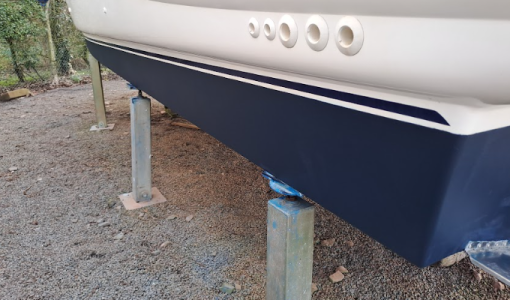

Slight thread drift, but thats a good looking boat Fred. You don't see many in the UK. From the pic it looks like its on shafts. I wrongly assumed it was fitted with pods. Must be very handy having a drying dock at your club moorings (y)
Suspect only one imported to UK.
Pair of Yanmars on shafts with V drive gearboxes. No electronics apart from throttles. :)
