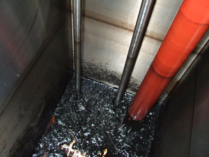

It might be worth finding out what is in the bottom of your tank. Here's what was in mine:
If you have a Pila extractor you can stick the "wand" into the tank and sample from the bottom.
You need to clean the tank, crud and water will not just go away.
