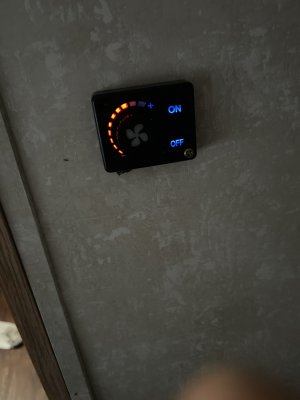

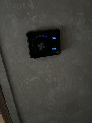

Concerning a thread I happened across. Where a gentleman was inquiring about which controller to opt for w Chinese diesel heaters.
I’ve included two photos of the on I have . I have owned my diesel heaters for 3 weeks and have not been able to get two straight days of use out of it. Instructions are useless for my application. These two photos I included are what controller has decided to do now. In steady format blinking. I had installed two of these for friend f mine in their individual motorhome and coach. Phenomenal results. Get on for myself with controller being the only difference (mine has the 4 port duct as opposed to the single duct I have installed)
Any help please

The number of leds blinking gives the fault code.
Thank you, the moment I read your words it clicked. You should consider writing Chinese instructional material . Call it “For (La((me)n))”
