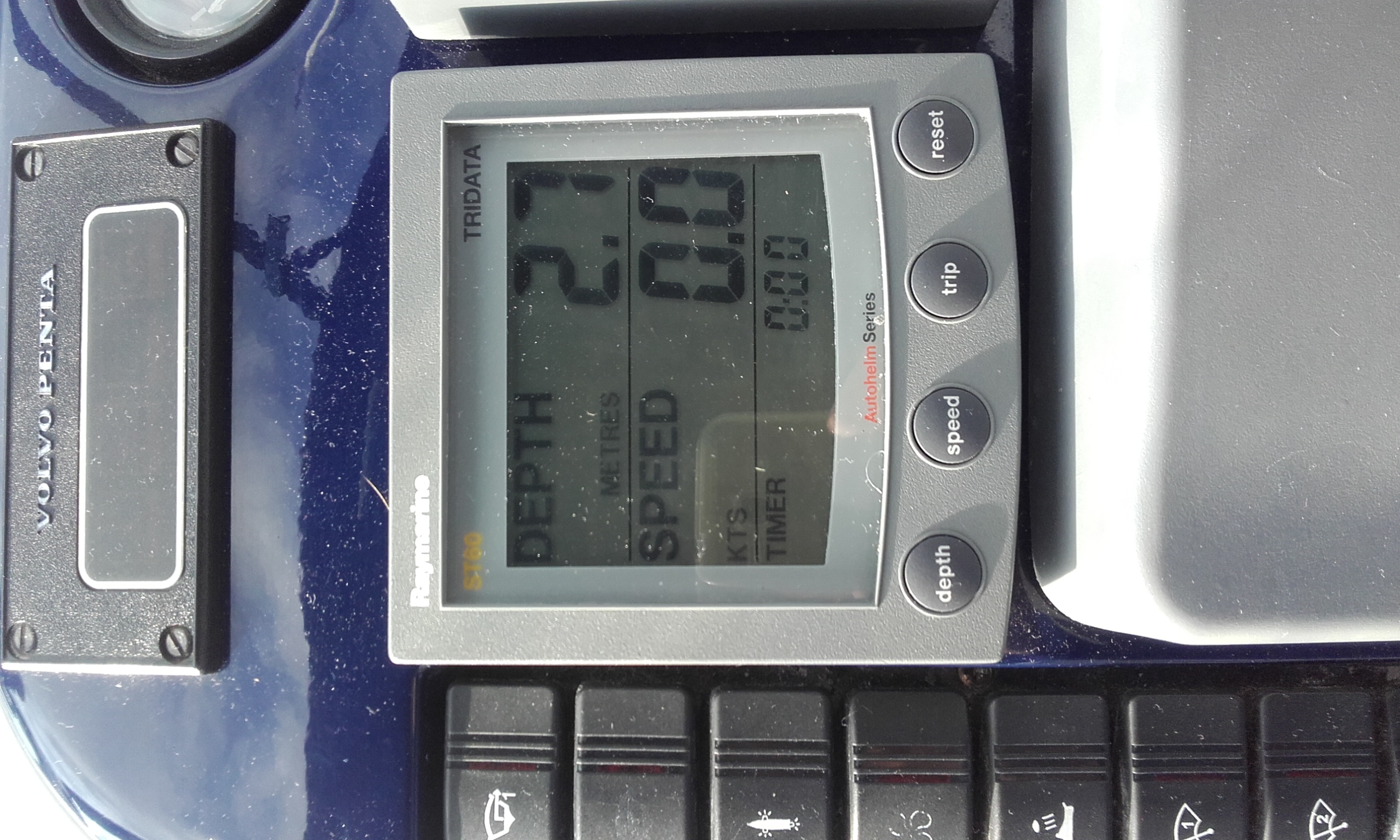

I'll check the angle (I assume it was factory fitted) but suspect that even if it was mounted at the wrong angle it would find something solid to get a reading from, even if totally inaccurate. When I'm there next I'll check the connection to the tri-data, the angle and the glycol level. 71ml is pretty precise though so I'll have to get a syringe! Note that the excess cable for the depth sounder and the log have been looped and cable tied in place and one of them has a load of insulating tape on it so it could be a bad connection there.
As the sender has no moving parts, do they ever fail?
Agreed re the angle it would show something .Yes its accurate so I used a syringe also. Don't think the looped cable and ties should be an issue but the insulation tape sounds a bit suspect- unless its a damaged cable, I cant see the need for it- that could be the problem . Sounders do fail mine did hence the P79 because I wanted a quick fix without haul out. I have also the B60 through hull which is very reliable so always have a back up.
