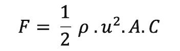

You have to consider why the cups go round at all! It's because the drag coefficient of an open hemisphere (cup) is higher than the back face (the ball). The Aenomometer, unless it has lots of friction (it shouldn't) will thus turn with the result that the ball side goes against the wind and the cup goes downwind, accelerating until the force on both are the same.
Using the Raleigh formula referred to above, the force is:

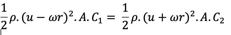

So, equating the force on the two cups:
Where the rotational speed is w radians per second, and the radius of the anemometer is r. A is the area of the cup, and C is the, shape dependent, coefficient aka drag factor.
An open cup has C1 ~ 1.4 and the closed (ball shaped) cup has C2 ~ 0.4
So, solving the quadratic equation for w gives
This is independent of density: the rotation speed depends only on u, the wind velocity. Same reading at 6000 feet ASL just as rogerthebodger said.
