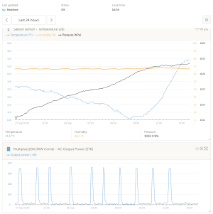

We’ve a dessicant dehumidifier, Meaco DD8L, I leave it on the one drip, low fan setting. It maintains a constant 66%rh on board whilst unoccupied. No problems with mould or damp experienced. Below is past 24hr graph, the lower graph shows the frequency of dehumidifier cycle on/test/off.
I do exactly the same as Gem43. The boat feels fresh and no woodwork issues in 12 years of doing this from September to March. Make sure the drain tube has a steady angle which will not airlock and seal her up
