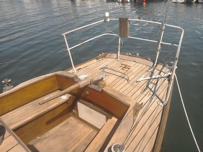

First photo shows the cockpit and aft deck of my old boat. The two floor panels are 12mm overlaid with 4mm teak faced ply and the seats are 1.5mm in this case laid on epoxy. The teak decking was nominally 4mm teak strips laid on Saba. The cockpit was done in 1996 and the deck in 2014. Photo taken in 2019. Good looks maintained by a cockpit cover when the boat was not being used and an overall cover in the winter.

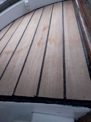

Second photo shows 1.5mm strips laid on CT1 on the coachroof of my current boat last year
