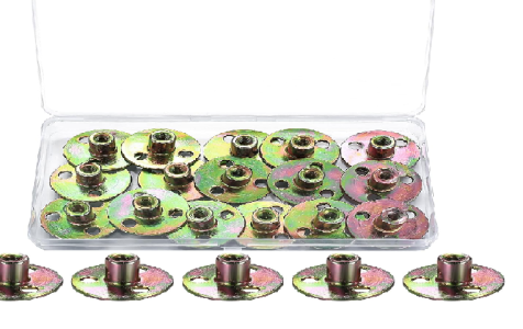

Poignard, your plan looks like a good one. Also thanks - so that's what those things are called!
One question though: isn't it tricky to get the epoxy plug to bond to the top layer, from underneath? I've only managed to do that from the top... maybe I didn't use enough thickener.

Just as a matter of interest, my sheet tracks are through bolted with nuts and washers and after an energetic sail they sometimes leak. I am changing the nuts and washers to mounting plates which should perform much better.
