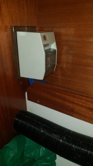

What you want is very similar to what I have. A simple set of 240V sockets in the galley, a water heater circuit, a socket to the cockpit locker and a fridge circuit. They are wired to a small consumer unit with RCBO type circuit breakers.
What I have:-
- Shore Power cable.
- Shore Power inlet socket in cockpit coaming.
- Galvanic Isolator.
- 4 x bay consumer unit. It came with inlet breaker RCBO type. I had to buy breakers for each circuit.
If fitting 240V sockets, and you use mobile devices, it’s worth getting the type that has a USB socket so you can charge devices.
My battery charger just plugs into the socket in the cockpit, which is also useful for power tools. I have corded power tools, hence to me it’s useful.
I recently changed out my consumer unit for a new one, and the cost with one inlet RCBO was only £29.99. Note that the inlet RCBO will probably be way oversized as it’s sized for a house. Easy to replace with a small rated RCBO.
All in all a very simple installation and low cost.
