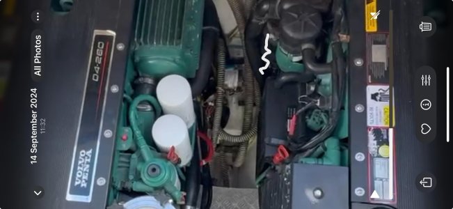

attached is the best picture I've got of where the offending salt trail was - if I've remembered correctly, not sure it helps though on the urgency or not!:)

Surely it is just a case of tightening the jubilee clips (not going at it heavy handed), wipe it clean and monitor for any new salt deposits. I can't see why an engineer would say catastrophic failure, in my opinion it's normal practice to check jubilee clips and tighten slighty if appropriate. If that's all it is, I can't see any problem using the boat and monitoring that area, obviously if it is getting worse I would get it lifted asap.

this was exactly my thought, but I guess I was a bit spooked by tails of catastrophic failure, hence why I asked for an opinion here to see what others thought and/or had done themselves. Good to see most are veering towards nipping them up and monitoring.
Simon - I'm unsure as I've only had the boat c18month and can't see a receipt for any direct work on them. I appreciate it's difficult to assess what's going on inside, but eternally at least they look reasonable. In a perfect world I'd just lift out next week and replace all that is necessary, however I don't live in a perfect world - Between engineer availability and logistics associated with the lift out it's not that simple, hence the ask for opinion from the knowledgeable folk here.
I'm very much leaning towards getting a 2nd opinion and nipping them up.

My previous boat had a d4 260 engine, it developed a leak from the exhaust elbow.
On mine it was not leaking from the large diameter rubber hose that connects the elbow to the exhaust horn , but was from a plastic fitting that bolts onto the elbow that allows some water from the cooling system to mix into the elbow.
you can see the bit of the elbow where the plastic fitting bolts on in oldgits first picture (the circular holes, the d4 only has one hole though) . The mating surface of the elbow was so corroded that it didn't form a good seal with the plastic fitting anf had started to leak, so no amount of tightening etc made any difference. It actually made things worse as it dislodged more corrosion making it leak more.
I ended up replacing the elbow.
I think you're just going to have to inspect yours and make a judgement call.
After I tried to improve matters by tightening things, it became worse and it was leaking too much, so I replaced the elbow.
I'd put money on yours having the same issue if it does use that plastic fitting. I think not all d4 260s use the plastic fitting, some are just blanked off.
