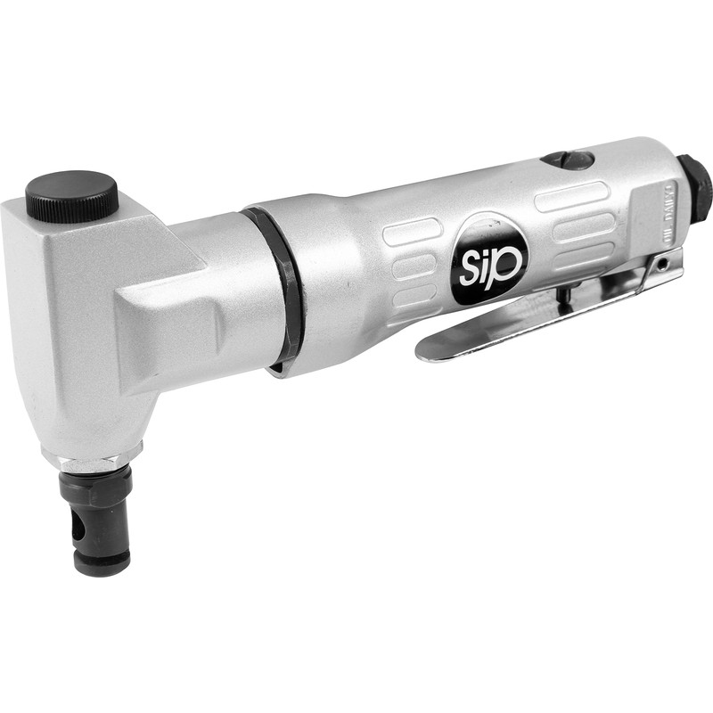

I drill holes in each corner and the use on of these tools as below
