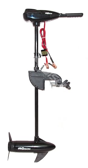

My crew has acquired a nice second hand Bison trolling motor. It has a very long shaft, but is destined to be used only on small dinghies, so a bit of trimming seems like a good idea - about a foot of shaft can usefully go. Has anyone done this? It looks as if it should be a matter of "Remove bolt holding top casing to leg, separate, cut leg, drill, re-assemble" with wires either shortened at the top or cut and rejoined at some stage in the process, but I wonder if I am missing any potential pitfalls.
The borrowed Shakespeare trolling motor (rebadged Minn-Kota, I think) which inspired the purchase had been cut down, so I know similar things have been done before. Well, at least one similar thing, but I'd be very surprised if that was the only one ...
