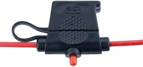

Perhaps worth mentioning that the fancy multi fuse on the relay bracket isn't indispensable. Mine became corroded and gave problems, so I changed it for one of these
Actually, not quite like that one, which is better because the LED will light up if you blow the fuse
