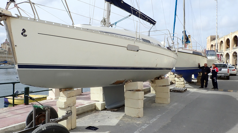

Ah yes, a picture speaks a thousand words! And you have mast down which is good. So you are restricted that you cant move pads backwards and forwards. You could put a prop under the hull in middle at rear and move the rear pads further up, after putting extra props beside the pads. Once tightened up you can remove the extra props. I would do the front and back separately, putting the pads back to their original position before moving to other one. I would put a sheet of plastic between pad and hull to stop pad sticking to fresh paint, it will be a bit soft for a while, just depends on conditions. You can mix up small amounts of coppercoat, you probably know that. Forgot to say to put prop under middle of bow before moving front ones.
Well, except that is a stock picture of the cradle, not my boat - and I have the boom off but the mast still up.
