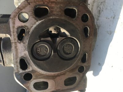

After wipe down with white spirit, soot seems to make a pretty good poor mans crack detector, assuming Im not misinterpreting these marks.
From the way dye penetration is discussed in the manual, seems like this might be a generic Yanmar faullt, here on a 1GM10.
Since I assume theres nothing practical I can do about it (best guess desperate countermeasure would be stitch-drill and then braze with zif-bronze. I think I have some rods somewhere and MAY still have the bits of a twin carbon arc torch for use with an ac welder, but I have never used either) Im probsbly going to do nothing.

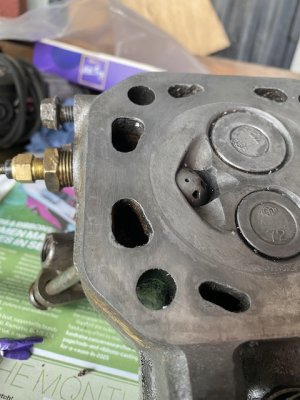

Would you say they are cracks as opposed to fuel varnish stains? Maybe try polishing the surface or at least the surface where you see one marking, with a light metal polish to see if they come off before anything else?
Yes I would say they are cracks, though happy to be wrong.
However, not really worth investigating further this time around, since I ve put the head back on, and if they are cracks I doubt theres anything practical to be done about it anyway
OP, you clearly know far more about this than I do, but if those were cracks running perpendicular all the way to the exterior wouldn’t they be visible on the outside? As far as I can tell, there’s no sign of any cracking on the exterior, only on the face.
And wouldn’t actual cracks show up as thin, sharp lines rather than broadening dark patches?
If so, that does suggest Anibal may be right.

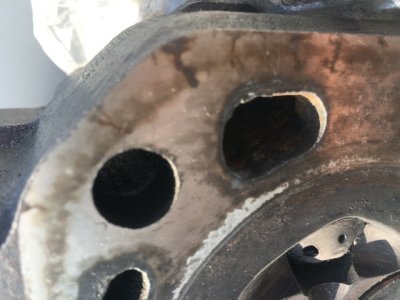

i dont know much at all. Only diesel Ive ever opened, and if its cracked only the second cracked head Ive seen, the first being on a SAAB 900, associated with HG failure, and running between the valve pockets, as you might expect and as is probably classic.
That said, and while I am of course happy to hear its not cracked, I wouldnt expect to have necessarily seen fine cracks on the surface, because its rougher, was dirtier, I ground aluminium onto it with a sunflower oil binder, and because I didnt really look.
Clean up with pie dish aluminium. There are silvery lines corresponding to the “cracks” but only show at certain angles and not on camera.ECA98CEF-C467-457E-8A39-FB6804447417.jpeg
Aluminium wiped off with white spirit soaked towel. The “cracks” ate still there, but then so is some of the varnish. Id say still look like cracks to me, but by no means vonclusive

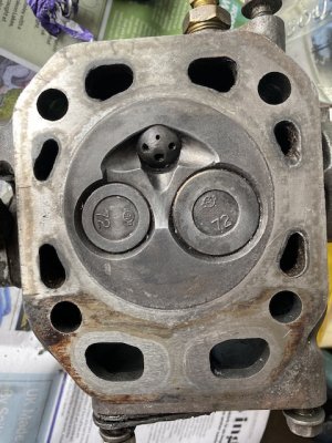

I think there could be tracking marks . I had similar on a water cooled 2 stroke cylinder head off an outboard . The advice I received was to to carefully grind the head face on a sheet of something flat like plate glass . In fact I used a porcelain tile as the flat surface and some very fine 1500 grit abrasive paper lubricated with water. PS I also used some Wellseal sealant on reassembly.
Whats a “tracking marl”?
Think Ive heard the term used for HV arcing on distributors and sich, which of course this isnt.
I suppose I could/should check for flatness deviation, which could be corrected as you outline. Plate ( or “float” glass isrecommended because its flat. This is an iron head though, so harder to hand flatten than an aluminium one.
How was engine running before head removed? I’d say even if they are cracks they don’t seem to be in a ‘bad’ place on cylinder head, ie - not in a place that’s going to leak compression.
Nope. That's not how they crack or what they look like IME. Rest easy.
If you are really curious, can't sleep, buy dye penitrant and follow the instructions.
OK, thanks.
Not interested enough to shell out for a real dye kit, which I suppose Im not guar a nteed to find more interpretable than dilite dirty oil
