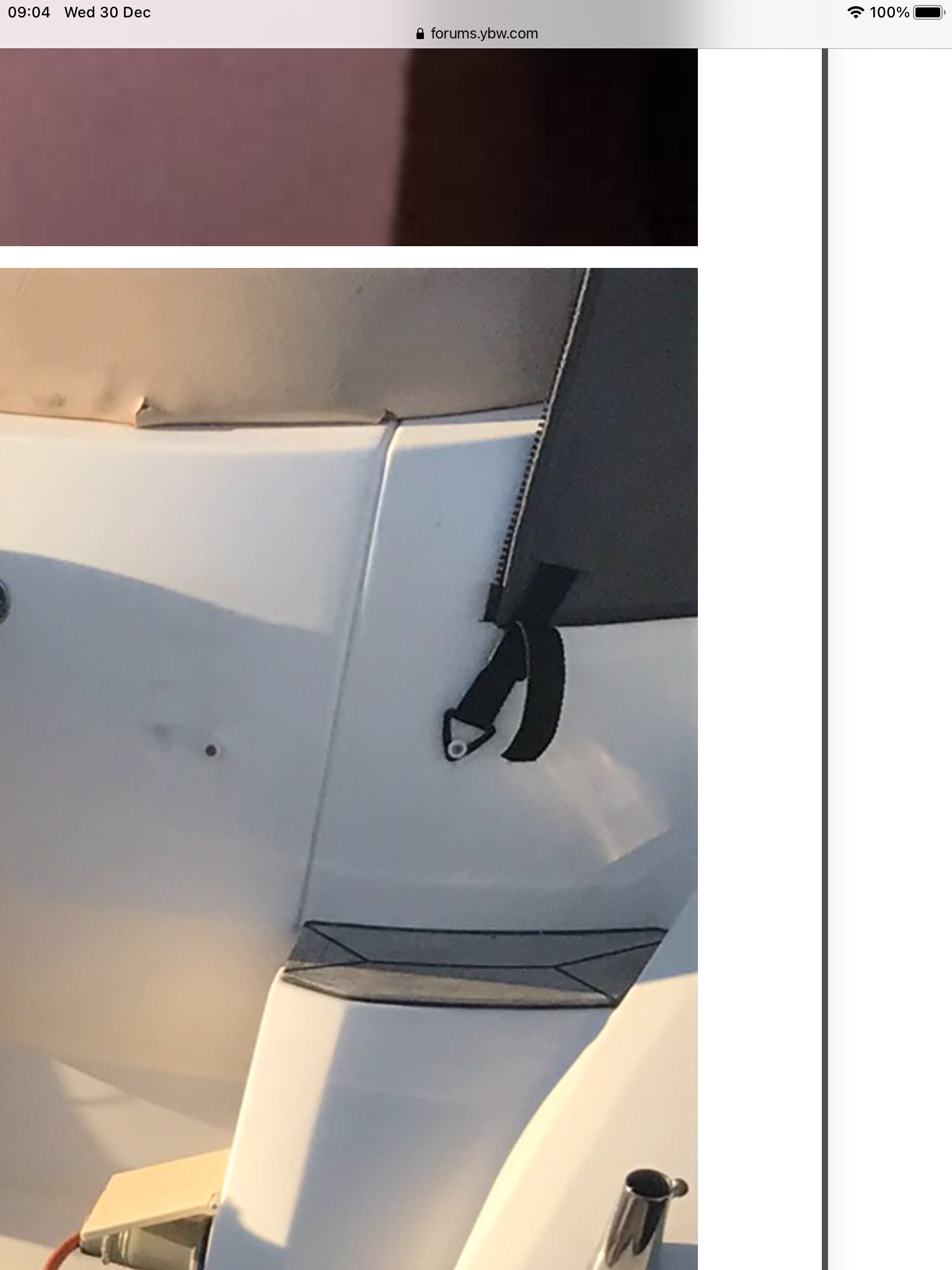

I notice on one of Luke’s pictures (hope you don’t mind Luke) that he has what seems to be an improvement to his cover fixing. I just have the conventional poppers.
I had new covers made in the UK, almost a year ago now, and they will be eventually fitted in Spain. I have the opportunity of a better and easier fixing method.
Is there a downside to Luke’s system?
Is there a better one?
Cheers guys and a happy new year.

I have Luke's type for the rear of the canopy and tonneau cover. Far and away better than anything else for the simple reason it allows you to precisely tension and mold the cover.
As for Hurricane's postulation about blowing off. Forget it. I've also had them fitted around the first 2 clips round the corners. I can cruise with the sides and front corners off and the back stays solid without wind flap or vibration. As for strength they easily out perform poppers in every respect.

Oh no, They arent for the front. Rear and rear corners only. They tension down the whole tonneau or canopy. You need to be able to tension from a fixed point screen / radar arch etc otherwise the whole system just crumbles.

This is where those straps excel. Fasten to fixed points in front when not under tension and tortion the back up. No more struggling with shrinkage, canopy movement or anything else. There has to be a reason it is in principle exactly what the HGV trailers use.
It’s not like that on my boat. The front pulls down from the arch fixings and the rear independently pulls down the other way.
However straps on the rear would significantly help with the winter tonneau cover which does pull directly from the front fixings
