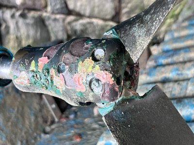

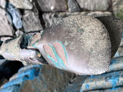

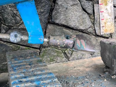

For various reasons all of which are my fault, I neglected to replace my prop anode at the expense of some prop degradation. See photos.
The anode has now been replaced and the prop still feels strong but have I left it too long and is there anything else I should do to immediately halt the process?
Many thanks
Lesson learned.

not a Brunton. just a simple folding prop. clean it up and see how deep the pits are plus whether it rings true. Unlikely to fail but the pits on the blades may affect performance.

I have seen folding props like this on which the teeth at the blade bases have dezincified badly and collapsed. This of course would prevent the prop from opening correctly. The pits on the blades can be ground out a little but if the teeth have failed it is scrap.

Thanks Sandy and everyone else. It is a flexofold and I got an immediate comprehensive reply from them. Apparently it wasn't the anode at all - not galvanic corrosion . I have a new problem to fix asap - electrolysis caused by stray current.
WIll break out the multimeter this evening!

Good luck with the multimeter, I did see that anode on the prop shaft, scratched my head and wondered why the pits were as big as our potholes when that anode looks hardly touched.

Yes and connected to shore supply. I've installed a new chart plotter and stereo in the last 18 months so will first check stray current in boat systems and then stray from dock. Although I do have one of those galvonic isolaters in place. In any event the red colouring on the prop says this is happening "now" so i'd better get my skates on and disconnect the internal batteries until problem solved. I was looking for a job this Easter!

Well put! The GI i had installed clearly did nothing to prevent electrolysis. I've disconnected everything and have the professionals looking at the cause. It's going to be an insurance job for a new prop and to check the skin fittings newly installed only a year ago.
It's true though - don't trust marina power!
