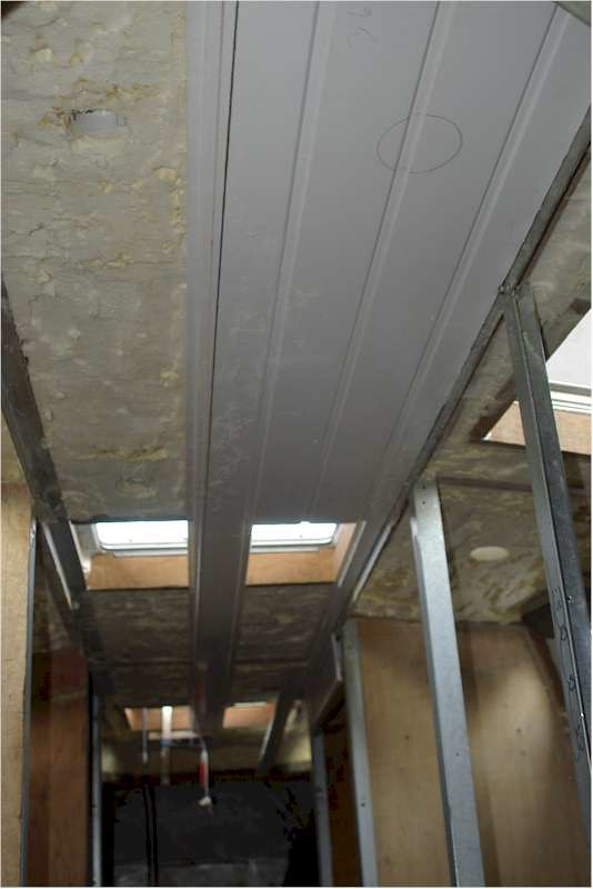

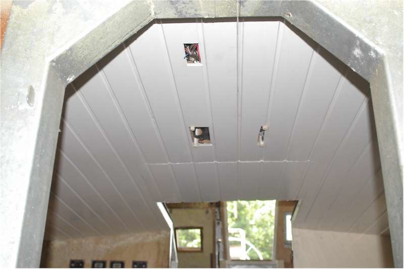

I used PVC tongue and Groove soffit as roof line on my boat I built 10 years ago
300mm PVC-U Hollow Soffit Board - Tongue and Groove
I used the 100 mm wide which made it easer in the detail shapes.
100mm UPVC Hollow Soffit Board - Tongue and Groove

I've put a gentle curves in my PVC roof but using a heat gun gently. I've also removed slight dings by playing a heat gun over the ding and the ding comes out due to the plastic memory.
A previous owner has actually managed (or paid someone...) to get this stuff up as paneling on the inside of the topsides in our saloon and forepeak. Quite an impressive job, as it all lines up and looks 'professional'. I'm not mad keen on the plastic feel (I'd prefer wood strips) - but headlining is a different story if the alternatives are vinyl, carpet, etc.
I did the main cabin and forecabinin my cat in the simulated T&G in white UPVC. That was 11 years ago and still no yellowing and looks terrific and is easily cleaned. Also because it is a box section structure it does not give condensation at all. It comes in widths from 600mm wide, 300mm or single "plank" width 100mm. The fixing screws are hidden in the tongues, these are only small as it is so light. It needs good planning to ensure that if you had to remove it you have access to the screws, jusyt needs a bit of thought. The edge and H joint trims (for the centre/lights fitting enable a very neat job. I did about 10 sq metres for about £70 including all edge trims and it is not much dearer now. I used Eurocell who have branches all over. If I were doing it again I would stick it with grab adhesive apart from places near light fittings that I might have to remove.
It will do curves in both directions but is easier across the boards.
Just checked out eurocell, not much more expensive than correx but looks a lot more substantial.
Yup, that's what was used on our boat (like @Rogershaw's example) - not correx-type sheets themselves.
Can affirm what @C08 says about condensation, yellowing and cleaning. It looks brand new. Just wish it wasn't uPVC! ? (but we've got lots of teak/vaneer so it looks a bit out of place, that's all)
