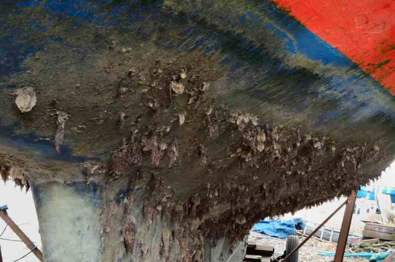

Mine looks just like that at lift-out, BEFORE pressure washing, using a copper based antifouling. A picture after pressure washing doesn't actually tell us very much. Sorry.
I am just wander, do you have any photogrphs before pressure washing?

Alas, no pictures.
But realistically, if an antifoul doesn't work where you keep your boat, it isn't worth the money or your time to apply it.
I will continue to use antifoul on my boat, irrespective of how easy it is to pressure wash CC and the fact you don't have to reapply CC afterwards. These add no value to me.
April to October 2016. Cruiser Uno. Portchester Creek.
