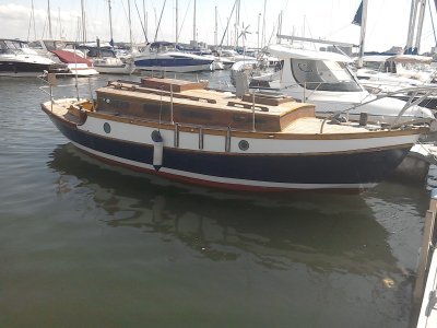

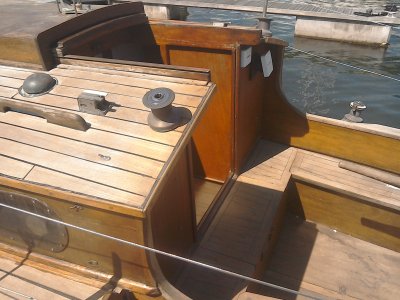

This is the one I made for my Eventide. Iroko sides and front. Central fore and aft beam also iroko and ply top (8mm from memory). Flange around the bottom and screwed down to coachroof so removeable. Drain holes in the flange in case any water got in. Lot of work but end result very good.
Anyone still interested in teak decking, this was the deck I laid, glued and caulked with SabaIMG_20140101_020254.jpgIMG_20140101_020154.jpg. Photo taken 5 years after laying but just had a good clean. Cockpit seats teak veneer laid on epoxy with epoxy/graphite caulking. About 25 years old at this point. Doing much the same on the GH but using polyurethane this time instead of epoxy.

Every time I dig out photos I wonder why I sold it until I remember the number of times I banged bits of me on bits of it and struggled with its wayward low speed handling. My GH gives much the same experience but with less banged bits and hopefully less long term maintenance.

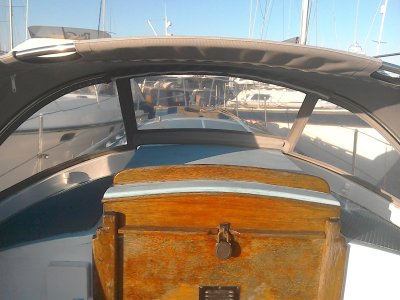

This was our solution to the bottom of the sprayhood over the sliding hatch. The batten holds the shape well. When (if) I get round to building the garage this will obviously be reconfigured to fit.
