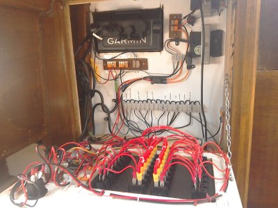

Don't recall seeing any terminal strips with screw connectors one side and spades the other when I was looking for such things. I made up my own by gluing Wago 2 way or 3 way connectors to a ply board similar to the one you can see in the middle of the photo. Very simple, flexible cheap and secure. On my current job list is feeding the mast wires through after stepping the mast.

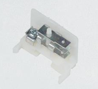

A search for "screw to tab terminal block" yields several options. This example has one screw and two spade connectors but they can be interlocked to provide as many as you require.
https://cpc.farnell.com/hylec/hy508-2-v-3f/terminal-block-2p-m4-screw-3-tabs/dp/CN20556

Actually the one I posted has a screw on one side and three spades on the other.
This is a picture of a variant of the above, just one row and it shows the screw and the tabs.
