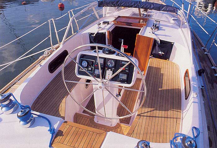

Latest boat has doors (and a higher bridgedeck) very similar to the Nauticat above with perspex panels in a teak frame. Much prefer this set up as no stowage problems and look as strong as washboards when closed. Look smart as well.
Is that a Bavaria? I didn't know that they did any with doors - was it standard or an option?
Standard on the Farr designed 33/4 and 37 now although some years it has been an option, and have been offered on other models as well such as the 2008/9 38 and 43. Some are plain teak veneered ply and others like mine are solid teak. As ever with Bavaria they tend to change such things regularly, so difficult to be precise.
