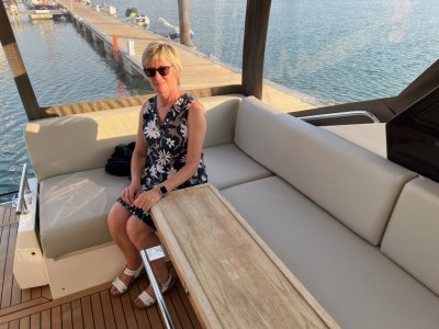

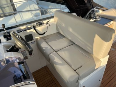

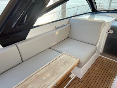

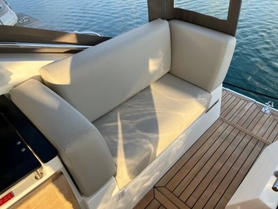

Mine was Sunberella “ Nette “ not silvetex .Apologies senior moment .I was looking at FB posts and remembered the actual product .Anyhow it’s doesn’t stain and works really well .
On our particular boat it’s designed un fussy simple lines with a lot of subtle details you don’t notice unless pointed out .
Eg the sausage roll would not work or look wrong because the seat bases are not vertical .There’s no cabin under , just storage .Cockpit over the mid engine room so flat sole .
The bases slope under a bit for your heels to comfortably be placed without banging them on the bases .So your knees joint in effect does not need any extra elevation that a sausage provides to kick the heel away from a vertical side …..if you understand my meaning .
We had stripes in the previous plastic and wanted to move away update .The “ slabby “ zen like minimalist look suits the boat .We like the de clutter look .
Its not everyone s taste ( boat and colour scheme) obviously each to there own on that .
A few colour coordinated cushions ( sorry no picks ) or beach towels breaks it up .
No clutter …..yet !
The cushions are feathered to go over that lip …..they sit kinda inside .
Few cushions, the blue are the same colour as the Bimini and the rear tie down straps to lift it a little .Just a little .
Re subtle details un noticed at first pass ….note the Bimini frame upright has a kink so it’s vertical bit parallels up with the widow frame . See the overhang , or base slanting under the seat cushions.
Beach towels .In the Med you are in / out the sea all the time @ anchor .This might not be as important in the U.K. .
Previous OEM plastic it used to ruck up , dew or condensation + any red rain would pool in the groves .
This newer Nette does not do this and dries faster …..or seems to .
It was a bit like throwing a dart at a board in some senses , until you actually release it there are lots of permutations that would work and an equally some that wouldn’t.Anyhow we are very happy with it .In particular the colour .
They are very simple uncluttered clean lined boats.Even the anchor kinda tucks away ….simply.Winch hidden as well .3CDAEA82-C75B-42E8-935F-62B789225F99.jpeg
Anyhow this Sunberella “Nette “ stuff seems great for upholstery.
Or course there other ways for those bothered by vast swathes of material or “ slabs “ to manage the issue :)

That particular sunbrella product -in post #24- is called Natte, and it's an acrylic cloth not a vinyl. Completely different thing from Silvertex, which is a vinyl, so the info in #17 was garbage.
The colour in post #24 pictures is I think Natté Cadet Grey, NAT 5073 140 . I had this on my last boat, Very nice and very hard wearing - I would highly recommend it. But takes a while to dry if it gets rain/spray on it, because it's a cloth.
