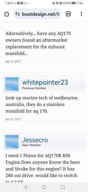

Hmmm, Replacing with new would be the better course of action. IF you can find one A STAINLESS version would be ideal. A quick google https://www.marineengine.com/boat-f...ifold-for-volvo-penta-aq165-and-aq170.451379/
Or see pic attached for another option
Think of the hassle of having to crawl into that tiny space again, especially if a stud is corroded, won't move, or snaps 🫣
400quid will seem like money well spent then....
