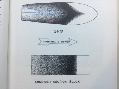

Here’s some info on the water pressure under a hull planing .
The solid black is pressure lifting the bow up .The white @ the posterior region is - ve that’s why the stern tends to sink planing .
50:50 is equal , more or less around the red line .
A seacock in those blue areas will definitely suck water out as -ve .
But equally a seacock in the heavy black dotted will pressurise as ARE correctly says and as I said just might get through a rubber impeller and start filling the exhaust manifold etc etc .
Obviously the pressure area on your particular vessels varies……speed , deadrise, hull L and other dims etc etc .
Never the less it’s not a done deal to dismiss this issue with a flippant “ BS “ .
It really does depend .

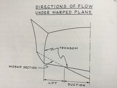

Extracts from Lindsay Lords book .”Architecture of planing hulls “ For clarity the lift area will be + ve pressure , so seacock here will have ingress of water .
Reading this book could save some folks future embarrassment 😀
I,m not joking , according to this picture my s**thouse is ready to explode when i open her up to go on plane . The flushing water pickup is exactly in the heavy black area 💩
