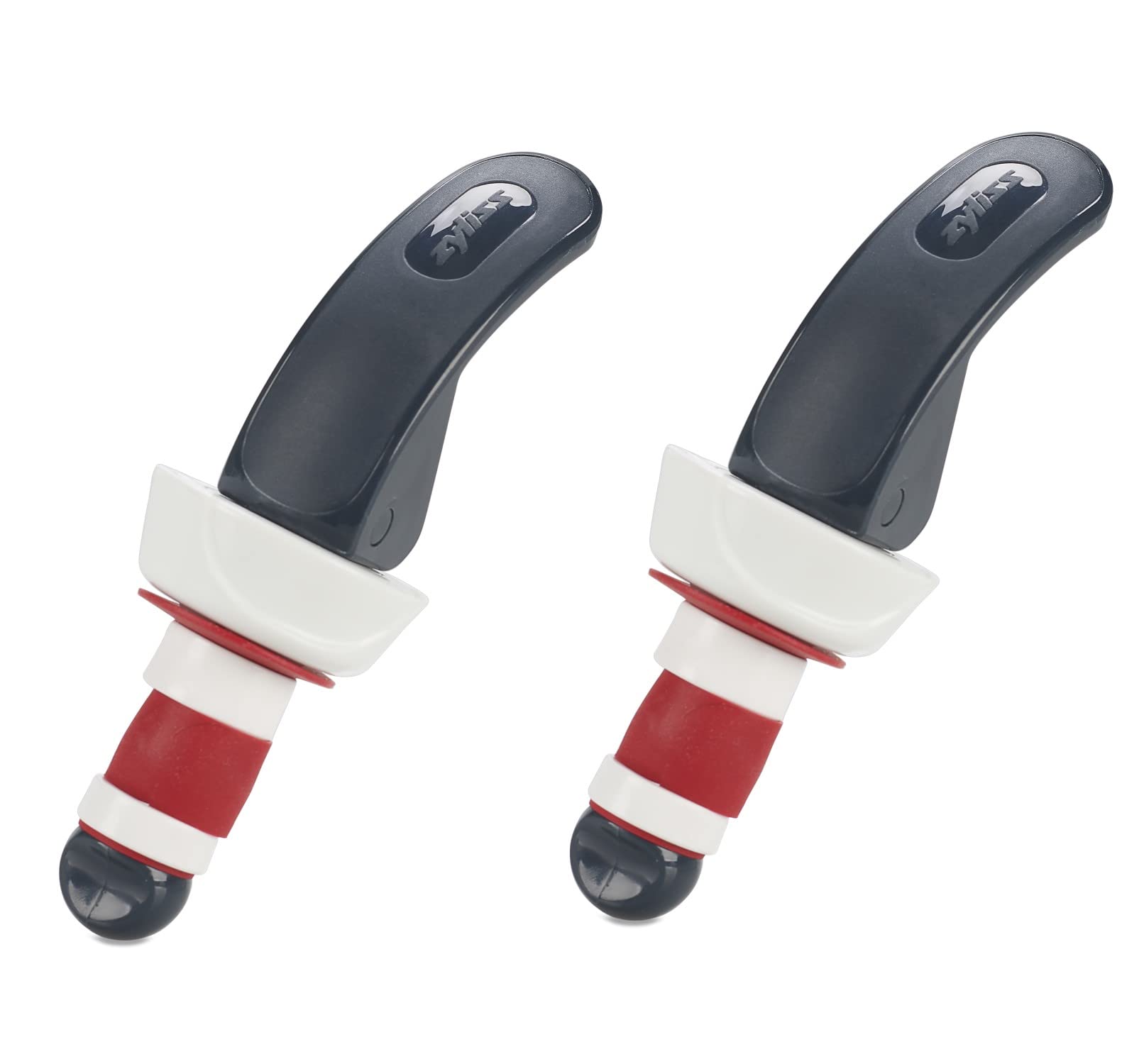

Lots of good suggestions. The drains are just GRP elbows that go through the hull and turn aft, so I don't think the ping pong ball idea would work without seriously reducing the effectiveness of the drains in the, admittedly unlikely, event that a wave should decide to join us in the cockpit. I like the idea of a rubber flap but, with the drain facing aft, I think the motion of the water as it hits the drain would just open it.
We're off to spend a few days on board, so I'll take exact measurements, and I'll order the dinghy plugs first suggested by Aquanaught.

attachment.php
We have a locol supplier of similar type
