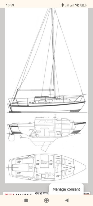

Hello everyone, I own a Seamaster Sailer 23 with the pivoting drop keel. I am having terrible problems keeping mud out of the keel slot due to berthing in a muddy, drying at low tide harbour. The keel jams in the slot constantly and I was wondering if anyone has found a workable solution to this problem. I've considered fitting thick industrial brushes either side of the slot or even heavy rubber baffles but as the keel doesn't fully retract inside the slot I'm not convinced it will work. Any advice or examples of a working solution would be gratefully received.
Thanks Alastair
