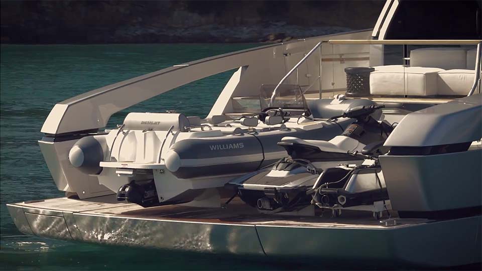

Just in case you didn't do the job yet, I came across an SX88 video where the very same cleats I previously posted can be seen on the swim platform corners.
Btw, one is raised and the other is lowered.
They are not meant as main cleats, and in fact they are the same size of mine - the larger ones are huge!
But if they're good enough for the SX88, they are bound to be fine for our boats too, I reckon...
I'm attaching a snaphot below, but if you feel like drooling a bit, you can also click on it and see the full video. :)
